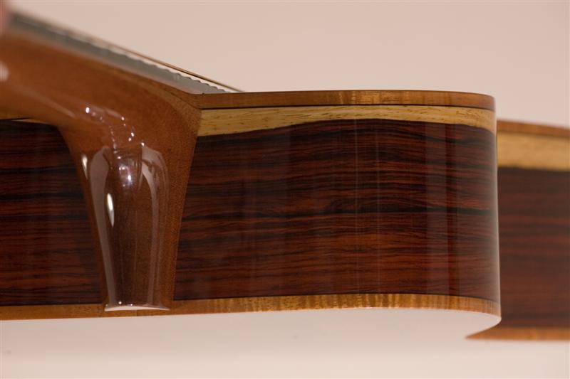

PostPosted: Wed Jan 18, 2006 11:45 pm
Posts: 8553
Here is a Matt Mustapick excample

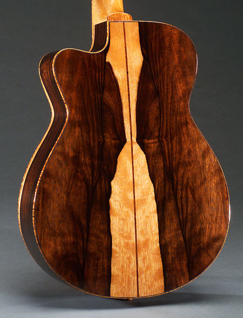

PostPosted: Thu Jan 19, 2006 12:15 am
Posts: 351
Sapwood is just as stable and dense as the heartwood. Think of sapwood as food storage and evenetually as the tree grows the sapwood will turn into heartwood.
As for using it in a guitar, it depends on the individual piece. Some sapwood is loaded with bugholes, bugholes packed with bug dung and lateral cracks. All of these can limit the use of the sapwood in a guitar. Lastly keep in mind powder post beetles, they love sapwood.
Just my 2 cents worth.
PostPosted: Thu Jan 19, 2006 4:57 am
Thanks Lance, it makes great looking guitars too!

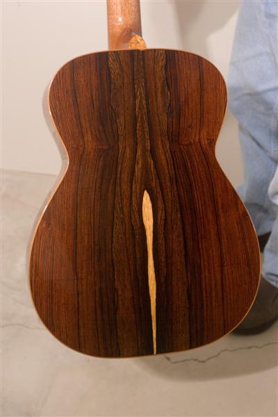

PostPosted: Thu Jan 19, 2006 5:23 am
Philip,
Try this example from Chris Jenkins of LINT fame. It is Brazilian rosewood, replete w/ sapwood:
You can see that he proudly uses the sap wood with all the "character" intact. I think such an appearance is an acquired taste, but someone will probably flip over this.
